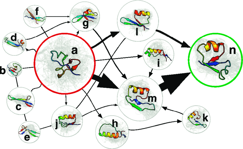

MSMs are analogous to the way that your favorite maps app creator infers potential routes and speeds from the GPS coordinates of their users.  In that case, they use GPS coordinates stored at regular intervals in time to infer where intersections are and the speed with which one can get between them. Most of us don’t drive very far. We’re typically just running to the store or commuting to work, not making cross country road trips. However, as long as there’s overlap between the intersections that we go through, the maps app creators can infer a map of the entire country (and beyond).
Likewise, MSMs build maps from a large number of simulations. Each simulation consists of protein structures stored at regular intervals in time, akin to GPS coordinates from a driver commuting to work. By taking advantage of protein conformations that are visited by multiple simulations, we’re able to identify common structures and the speeds of getting between them, akin to intersections and speeds of getting between them in our map analogy. Like a map, the MSM then provides a basis for asking all kinds of questions about what’s out there and how to navigate that space.

An MSM consisting of common structural states of a protein and the flux (akin to a speed) of getting from the state labeled “a” to “n”. MSMs can have anywhere from 2 states to hundreds of thousands of states depending on the resolution one wants.
