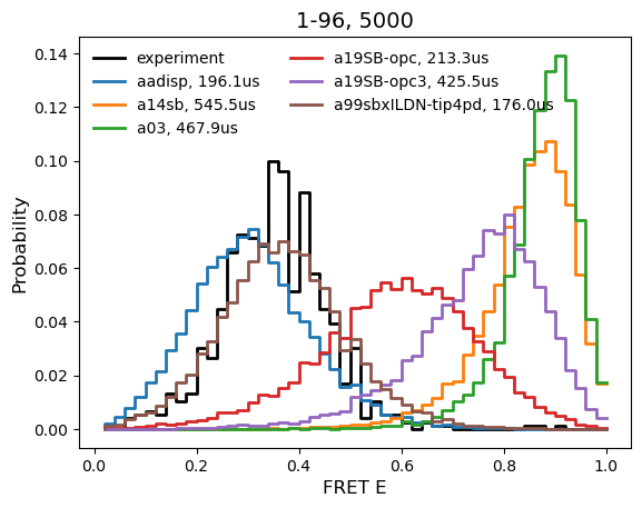

Over the past year, we’ve been performing extensive simulations of some disordered proteins with a variety of force fields and comparing to experiments called single molecule FRET measurement. Without going into great detail, these experiments report on the proximity of two dyes that are attached to different parts of the protein by measuring a phenomenon called energy transfer (E). We’ve recently developed powerful methods for predicting the distribution of E from large-scale simulations, providing a great opportunity to compare the distributions from simulations with those measured from experiments.
Encouragingly, some of the force fields developed to better model disordered proteins look really good! Our current favorite has quite a long name: amger99sb*-ildn with the tip4p (or tip4pd) water model. In the figure below you can see that predictions based on simulations using this force field agree quite well with experiment. In contrast, lots of force fields that work great for folded proteins do very poorly with this disordered protein, including amber03, amber14sb, and amber19sb. We’re also finding that the new force fields that perform well for disordered proteins continue to perform well for nicely folded proteins, so we plan to switch over to these force fields for all our future simulations.
